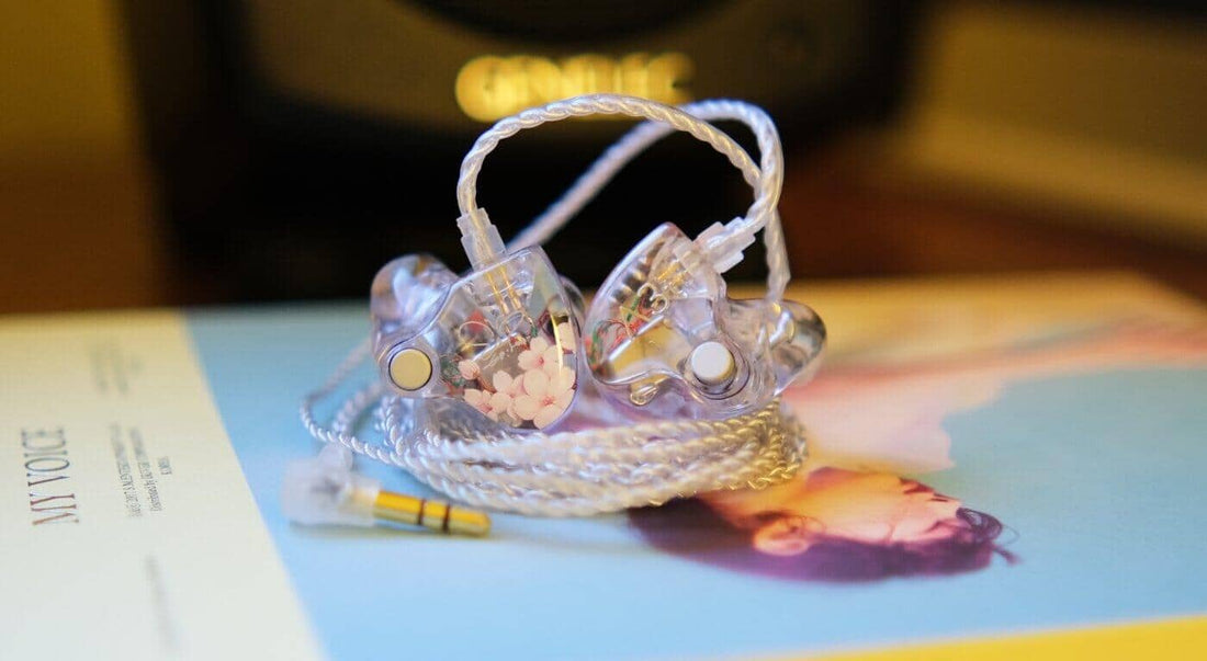

The A3t is a custom IEM, so the shell is shaped to the unique anatomy of a listener’s ears. This requires having ear impressions taken by an audiologist; in my instance, I mailed 64A a new pair of impressions that were taken in Singapore by Zeppelin & Co. It took almost exactly three weeks from the date of which I ordered the A3t to which they were in my hands.
The fit of the A3t is expectedly excellent, and I can wear them the entire work day with minimal fatigue. Build quality is good. There are neither surface inconsistencies to the clear acrylic, nor are there discrepancies to the degree of clarity throughout. At my personal request, my A3t was fashioned with recessed 2-pin connectors. I chose recessed connectors for increased durability and the connector’s stronger aftermarket support in cables (relative to the IPX connector). However, it should be noted that 64A’s customs use the more unusual 0.75mm diameter for their connectors, so some standard 0.78mm 2-pin cables will be difficult to swap in. The cable that comes with the A3t is cheap, but it gets the job done. For better or worse, the memory wire is surprisingly pliable, so I don’t find myself minding it too much.
One will observe that the 3D printing of the shells appears to be a three part process: there is a “cut” at the base of the nozzle where the nozzle is mated with the majority of the shell, and then a faceplate which is fashioned to the outside of the shell. A major appeal of CIEMs - at least for the aesthetically inclined - is the ability to choose shell colors and faceplate artwork. I chose to keep it simple with the clear colorway and some blossoms adjacent to the butterfly signature of my favorite artist, Taeyeon. It turned out exactly how I envisioned it!
