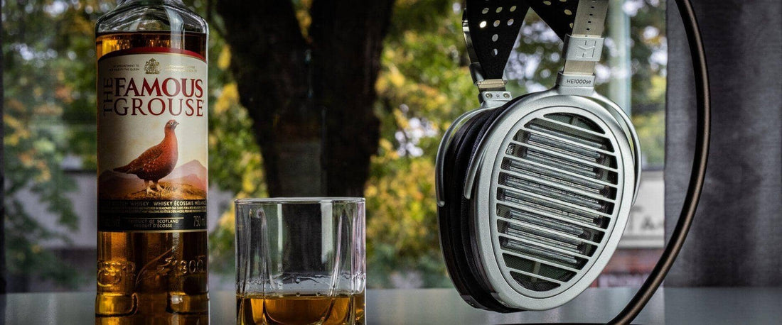

Hifiman HE1000se with Famous Grouse Whiskey

Design, Build & Comfort
The HEKse uses the same design shape as its predecessor (and the HE1000 V2). As much as I find this cup shape to be less than ideal, given its massive size, it has to be said that I don’t mind it as much as I thought - at least after my initial hesitancy.
While still slightly on the heavy side at over 400g, the HEKse does reasonably well for comfort, and actually I find it to be better than the Arya, in spite of the slight weight increase. This is helped by the improvements to the headband, and for some reason the clamping on the side of the top of my head I felt from the Arya isn’t as noticeable with the HEKse. At the same time, the design of the headpiece system is still not at all my preference. The sliding side pieces to the headband don’t feel particularly secure, and when they are set in an optimal position for the cups on my ears, half the headphone reaches my jaw. This is an odd experience, but on the whole not the worst, and it’s still an improvement over just about every other headphone I’ve experienced at this price - except for maybe the Meze Empyrean.
The build quality is also an improvement over the Arya, which felt cheap by comparison, however I’m personally not a big fan of the wood inlay. Sleek but sturdy is a good design choice to aim for, and HiFiMAN continues to miss that target. Still, the window shade grille and yoke system feels much more sturdy than the lower end models and that’s a very good thing. While they haven’t had a great track record for build and quality control, it’s clear that HiFiMAN has made some effort to make the HEKse feel premium, even though that effort won’t fully satisfy those of us who want it to feel as good as it sounds. This is still a far cry from the build quality of the Audeze LCD4 - but maybe that’s how you keep the weight down.
On that subject, HiFiMAN have somehow managed to use a double sided magnet structure without making the headphone unbearably heavy, and that’s a very good thing in my opinion. Supposedly the HEKse also uses what HiFiMAN have dubbed the “stealth magnet” that was implemented in the Susvara. The idea here is that the magnet shape is designed in such a way that it minimizes interference (wave diffraction) with the sound being produced. This appears to be done by rounding the edges of the magnets, reducing the overall area that could break up the wave. This makes me wonder if there’s any other magnetic ‘drive’ trade-off necessary to achieve such a design, and if this means gaining a benefit in detail at the cost of speed (or some other technical category). In any case, this is so far only the second implementation of this idea, and if the HEKse and Susvara demonstrate a successful proof of concept in the performance department, I can see it being implemented throughout the rest of the line.

Hang on! So…are you saying these headphones are like a cheap blended whiskey??
Great review Andrew. Cheers
