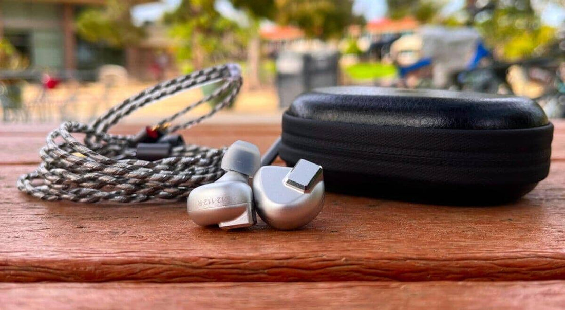

The construction of the S12 is CNC-machined aluminum; it sports a triangular shell with protruding bezels for the IEM's cable. Build quality is not great, but appropriate for $150. There is certainly an industrial allure to the S12's build that will likely appeal to some prospective buyers. Despite the 14.8mm planar driver inside, the S12 is also a medium-small IEM that I believe most ears will be able to fit. Of course, your mileage might vary given fit is 100% subjective.
In terms of the included accessories, I am not a big fan of the S12's included cable mainly because it has a tacky-feeling plastic wrap surrounding it. But it does get the job done, and I'd imagine it's also quite durable because of this wrap. The 2-pin connectors at the end are ever-so-slightly recessed. The case with the S12 is compact and works well; I have no bone to pick on this front. If you pop open the manual of the S12 (which I'd imagine you wouldn't touch otherwise), you'll notice that there's a spread on the back showcasing the S12 being worn by a lovely lady. Moondrop: write that down!
