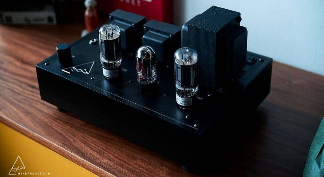

Ampsandsound’s Justin Weber runs one of the most interesting personal audio electronics companies in the industry. Classic, old school, no-compromise designs with startling amounts of power and current drive. The internals are nearly entirely turret-boarded with hardly a PCB board in sight, and the units are all hand built and feel just about earthquake proof. Add in the fact that he has his own custom designed transformers, something that largely become a lost art, and you have amps which totally eschew measurements and integrated circuit chip amps.
The same is true for the Forge , which has the same muscular industrial build and old school turret-boarded construction of Ampsandsound’s other amplifiers. Tube compliment is a triode-strapped pair of KT88/EL34/6L6GC and the input tube is a 6SL7. Unlike other pieces from Ampsandsound’s Justin Weber, this amp ditches the wooden sides for an all black construction, and the pictures don’t quite do justice to just how nice the finish is. And the sound?

[Editor's Note] - The Forge has two potential configurations, one with 8 ohm low and 100 ohm high Z outputs, and the other with 32 and 300 ohm outputs. For higher sensitivity or lower impedance headphones, it is recommended to choose the configuration with 8 and 100 ohm outputs. You may also want to consider this configuration for certain higher impedance headphones that may also have slightly higher sensitivity as well to ensure there's no noise floor.
