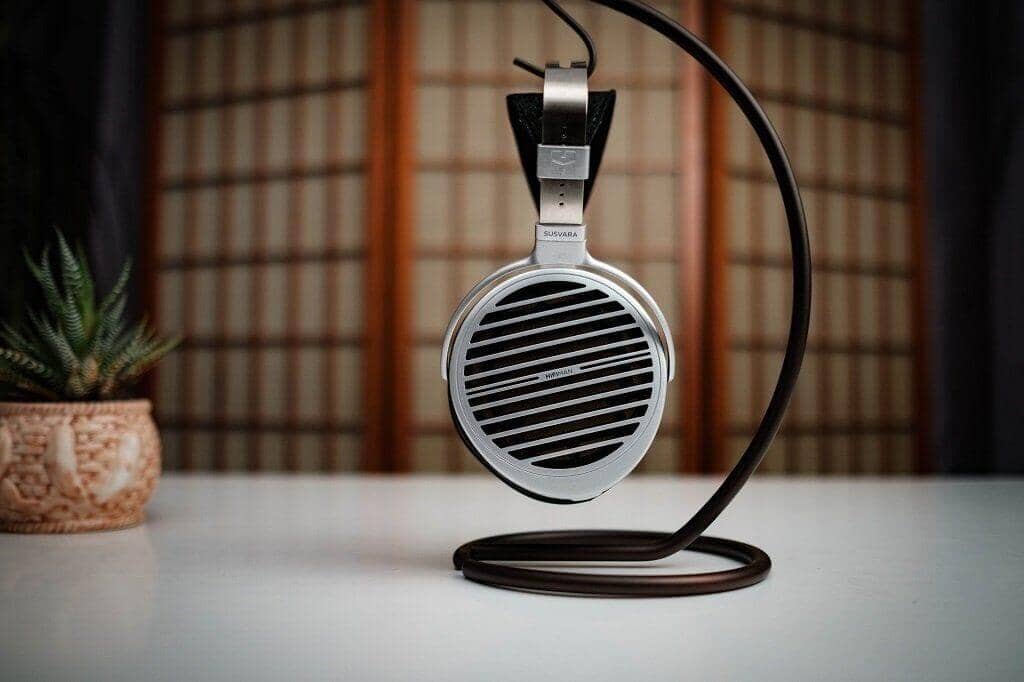

HiFiMAN Susvara Review - Endgame Flagship Planar
Review written by Andrew Park (@resolve)
This unit was sent to me on loan for evaluation by a community member from the HEADPHONE Community Forum.
For some time now, I've been searching for the perfect flagship planar magnetic headphone, and while I've been impressed by the technical performance and capability of many of the flagship planars I've been able to review, there always seems to be a trade-off in one area or another.
The Audeze LCD-4 has top tier detail retrieval and slam, but it's also far too heavy (over 700g) for me to comfortably wear for long periods of time and it also doesn't have the best tonal balance for my taste. The Final D8000 Pro (check out my review here) has a better tonal balance and frequency response for the kind of music I enjoy, but it's also not the most comfortable for longer sessions, and its technical ability - while close - isn't quite on the same level as the LCD-4. The HiFiMAN HE1000se has excellent technical performance, is reasonably comfortable, but also has an unnatural amount of treble presence above 12khz.
I'm no stranger to EQ, and so I do think many of these headphones are remarkable achievements and are worth owning, but so far I haven't found a flagship planar equivalent to something like the dynamic driver Focal Utopia - something that's comfortable, has top-tier detail and exceptional tonal balance all in one. My evaluation of the HiFiMAN Susvara has been an attempt to determine if this is that elusive flagship planar that I've been looking for.

It should be mentioned that the HiFiMAN Susvara is the most difficult to drive headphone I've ever reviewed, however it still didn't take me past ten o'clock on the volume dial once I put the IHA-6 into high gain. For anyone considering this headphone, you should also look into high powered amplifiers (potentially a speaker amp).
Build & Comfort
The Susvara is surprisingly well built. It's surprising because there's a common perception that HiFiMAN headphones don't have the best build quality - and I've had my gripes with this in the past, specifically with the lower-end HE-400i. I suspect that this perception has to do with the sub-par track record of those headphones, which were very popular, and this has led to the assumption that the rest of their products wouldn't fair all that well either. But so far, I actually haven't had any issues with HiFiMAN headphones that I've owned, or anything that I've reviewed. It's unclear to me what the failure rates would be on the Susvara, but from a look and feel perspective, it's excellent - far better than what's found on the lower end models.
The Susvara of course uses a planar magnetic design, and if I'm not mistaken this was the first use of their 'stealth magnet' system. Normally for planar magnetic headphones there are magnets on one or both sides of the diaphragm, and the magnetic array can potentially impede sound waves. But with the Susvara (and now the HE1000se), those magnets have been shaped in such a way (with rounded edges) to minimize their impact on sound waves being produced by the diaphragm.
Thankfully, HiFiMAN have managed to keep the weight down (450g), and while it's still not the lightest headphone out there, the Susvara is remarkably comfortable to wear for long listening sessions. It's also considerably lighter than its competition, with the LCD-4 reaching over 700g and the Abyss AB-1266TC reaching 630g.
Score: 9/10
